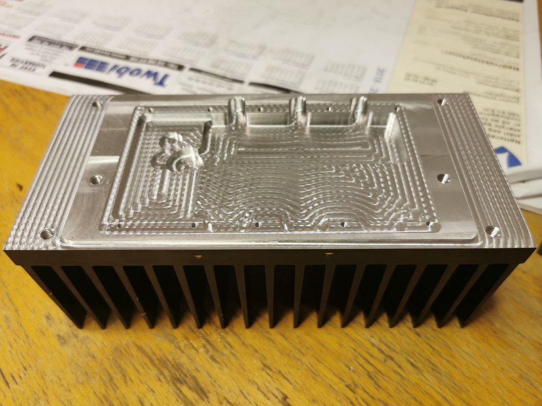

Hello Makers,
I found original 100250 could handle only 180A in a hot day. I have ventilated cooling with big radiator..
To improve performance, I milled copper block...
Please any one can tell the truth about 100500 controller? Any news?  ETA?

eptv
Last seen: 3 months 1 week ago
VESC Original
Joined: 2018-10-21 21:20
Posts: 36
Thanks for the tip about thermal pads!
Ordered some to try.
Also I'm going to try 0.05mm tape as isolator with good thermal paste.

Hi
I have th 75300 and get about 220A with better thermal pads. The 100250 will generate some more heat( mosfet with lover voltage have less internal resistance). How mutch better cooling did you get when chaning to copper ?

Markula
Last seen: 4 months 2 days ago
VESC FreeVESC Original
Joined: 2019-03-22 12:33
Posts: 29
ok i see. I removed the alu casing and milled directly into a large heat sink. Locking forward for your results!
Last seen: 8 months 3 weeks ago
It would be best to hard anodize the aluminum, so that it becomes non conductive. Then use a 17W/mk heat pad. 0.5mm thick.
You can also but a 8mm thick aluminum plate over the cover PCB to create even pressure over the entire surface.
eptv
VESC Original
Posts: 36
Results of copper block test:
It can handle 100A without fans. After 5 minutes of foc_openloop FETS 62C, radiator edges 52C, 27C ambient. Only 10 degree delta is good for me.
I assembled it with thermal paste and tape on the FETS:
