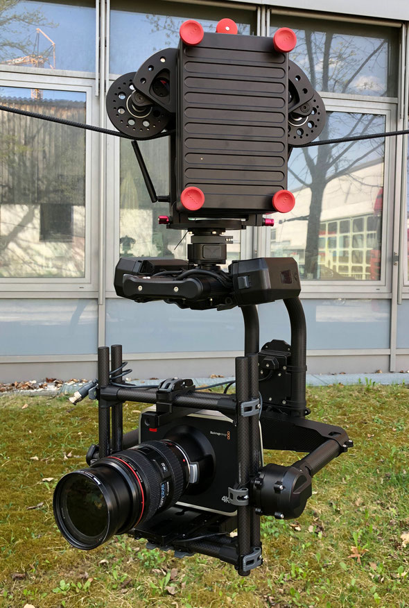

As I wrote a while back, mine is a CableCam. At speed=0 (and with Speed Controller's Minimum ERPM set to 0) I would expect the Cablecam to stay put where it is, even if the rope is going uphill.
https://www.youtube.com/watch?v=VLPpT_wAVdM
A poor man's solution and one that would work in all modes would be to energize one phase with a default amount of amps. If you guessed it right it will hold the position, if the value is too high you waste energy. The better approach is of course to blend in the positional logic at speed=0 to hold the current position with the energy required at of this moment.

wdaehn
Last seen: 4 years 5 months ago
Joined: 2017-09-12 17:26
Posts: 65

photokopter
Last seen: 3 years 9 months ago
Joined: 2017-08-23 11:35
Posts: 4
@Benjamin
Can you tell me when the handbrake will be implemented?
We urgently need it for the Cablecam
