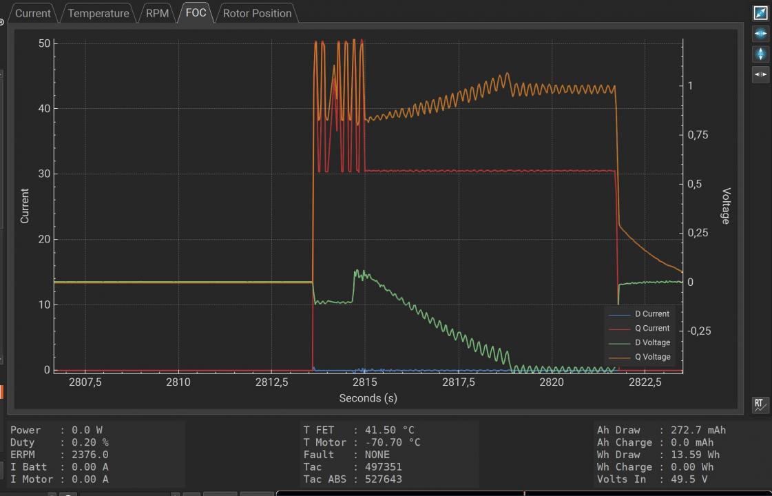

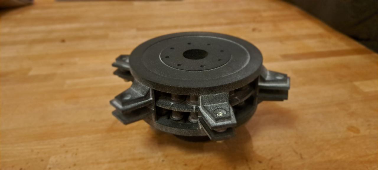

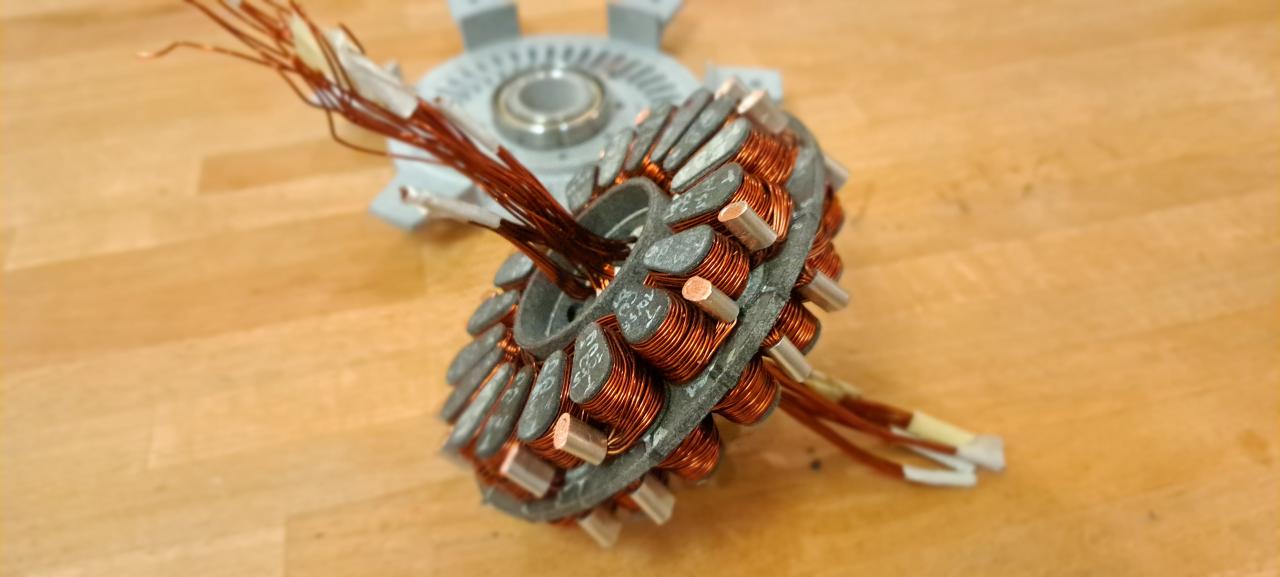

Hello, VESC & Ironless Axial Flux Nerds!
After a few years pause, I started again, with a new motor. It's again a axial flux, but this time a Double Disc Rotor, Double Stator design (=2x3phases).  The magnets are arranged in a Halbach array. 18slots/20poles. It's an outrunner.
Last weekend I had the chance to run it up with a VESC 6 I have (tested each stator separately).
So, weird thing. When doing the FOC wizard, it runs up very smoothly. No problem at all.
But any attempt to control it via the manual controls fails, independent from Current, Duty or RPM control.
Can anyone highlight me the diffference - or what is the FOC detection doing differently?
Thanks!
Tobias

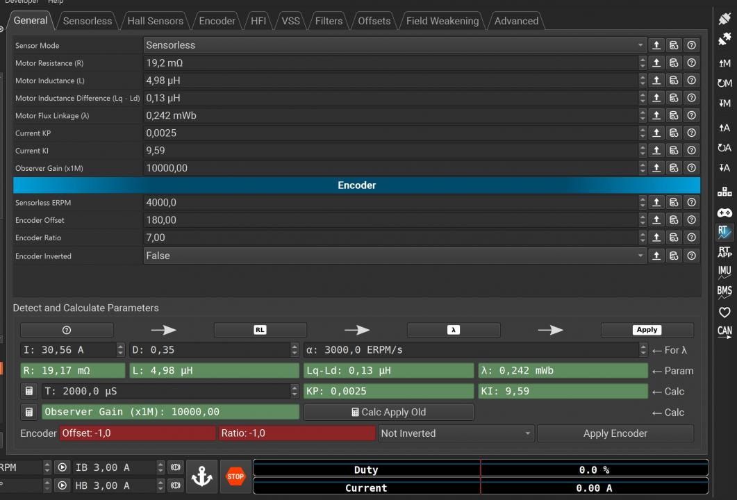

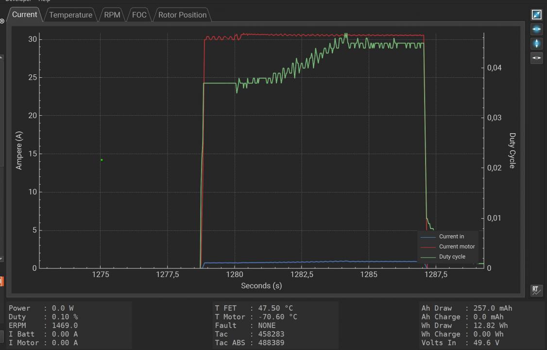

Hmmm....slow reply here....even though you have to pay $$ to participate here.
I've today tried all different settings, but non of them really worked (also increased the switching frequency to
  • 60kHz
  • V0 and V7 sampling
  • Current Controller Decoupling Cross Bemf
  • All kind of observers
  • Tried different open loop erpms (from 100....700....1400)
  • FOC detection
    • Detected Observer...12000 -> changed up to 20000, standard is 1000
    • T...250us to 2000us
It is still strange....FOC detection runs perfect:
But whatever I try in the experimental tab (Duty, Current, RPM) fails big time....sometimes it slowly "turns" in Duty cycle.
Has anyone a hint? (Maybe one of the team member to whom the payment for the VESC tool goes and who earn money with selling original VESC hardware?)
