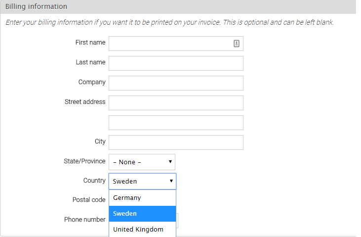

So, want to support... and can afford buying you a beer or two for your hard work... BUT i'm not in Germany, Sweden, or the UK...
Any checkout for us in the US?
https://goo.gl/A9Wq6Q
I'll try finishing w/o filling in, but worried my CC company will have an issue if billing info isn't correct?
Thx Benjamin!!!
EDIT - worked fine leaving it blank. Just a bit odd not to give billing info - but at least it works!

Thanks for letting me know. I have added all countries in the settings, so I think it should show them now on checkout.
