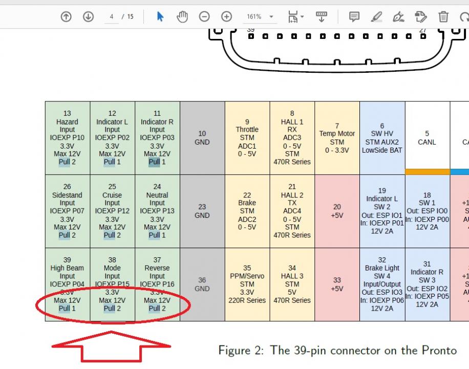

I recently bought a VESC Pronto.
I am struggling since two days with sth. that should be really easy:
Read the inputs of the IO-Expander but I do not find documentation about this.
(Why though ?!)
The slice of the schematic in the datasheet shows:
"Cruise", "Neutral", "Mode", "Reverse" and so on go to the TCA9535 which is connected over I2C to the ESP32.
So my attempt is:
Use I2C to readout the TCA9535 and forward this over CAN to the Pronto.
I can configure the TCA.
I can write and read back its registers.
My problem:
The inputs are always shown as 0, no matter if I pull the pin high or not.
My questions:
1) Is this the intended way to read the inputs of the expansion-chip?
2) If yes, am I missing something? My Testscript follows below. if someone could have a look.
3) I had to swap i2c-pins to read back the registers correctly. Is there maybe a mistake in the schematic or documentation or am I doing sth. wrong?
4) How to contol "pull1" or "pull2" net? Am I correct that these are intended to be controlled?

Edit: Add picture of Pull 1 / Pull 2
speed3r
Last seen: 3 months 1 week ago
Joined: 2018-11-15 15:55
Posts: 14
Regarding switching the pull-Network,
turns out the answer is in the schematic.. I was too blind to see it:
Pin 17 controls pull-down or pull-up of the network..
Regarding my posted test-script:
1) There were two brackets missing in the "read port" function.
2) The formatting in the print-instruction did not work correct. (I prefere Bitmasks, but it did not work well)
3) The "pulling" was missing leading to a lift of the hole network with one pin high.
This test-script worked for me, in case somebody is let here by a searchengine:
