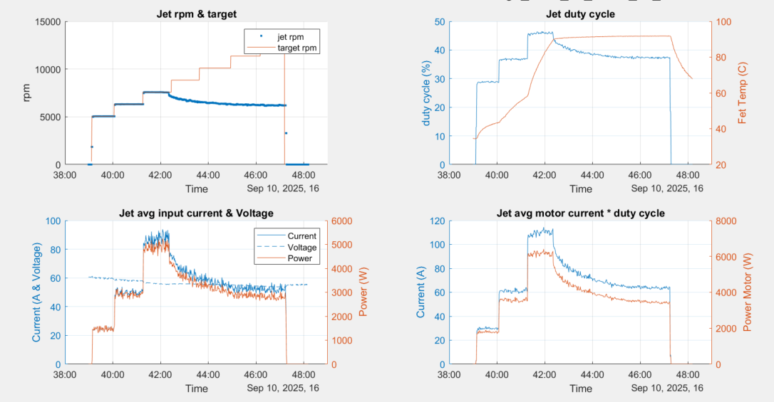

We followed your advice and used the FOC. The problem is that the  VESC is unable to work at higher velocities than 7500 RPM (see attached graph. What can be done?FOC Performance.png
electricfox
electricfox's picture
Last seen: 28 min 14 sec ago
VESC Original
Joined: 2019-01-01 17:11
Posts: 172
I can only repeat myself: Add more details/data. Motorconfig XML, App Config XML, Logs etc. There must be something limiting your jet. You can also read my signature.
