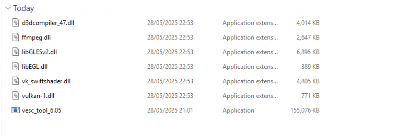

gregd72002
Last seen: 4 months 2 weeks ago
Joined: 2025-05-12 14:00
I had the same problem. The cause was that my graphics card does not support OpenGL (I run virtual Windows). All you need is ANGLE OpenGL library. Best place to get is from "electron" app. Download the 32bit version (as VESC is 32bit app) "electron-v36.3.1-win32-ia32.zip from https://github.com/electron/electron/releases?page=1.
Extract and copy all the DLLs from the Electron into your VESC folder. It Screenshot 2025-05-28 at 22.58.54.png
