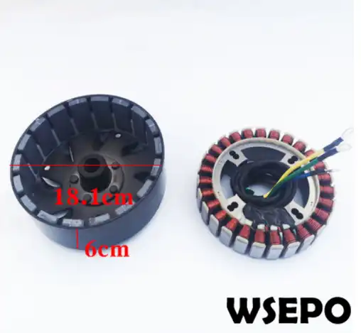

we use a vesc 4.12 (newest firmware) with a big outrunner, driven by a 200 cc honda clone engine to first start the engine and then to generate electricity.
the motor/generator is rated at 5kw and has 27 poles, kv number is not know, its supposed to charge a 24v battery with the engine running 3-3.5k RPM.

it doesn't matter what current limits i configure, and i haven't experimented with freewheeling or things like that that might explain this weird behavior. starting from a rpm of 1500 upwards the vesc is breaking without command and it gets higher with a higher engine RPM. it wasnt a hardware defect either as a completely different vesc i tried after frying the first is doing the same.

If the voltage at the motors windings is higher than the battery voltage (because it is spinning fast), regardless.of what the vesc is doing it will charge the battery; the body diodes in the mosfets will act as a 3 phase bridge rectifier.
