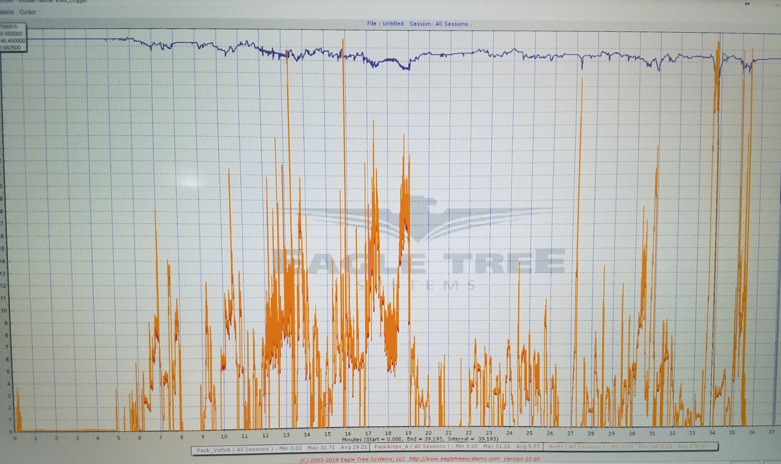

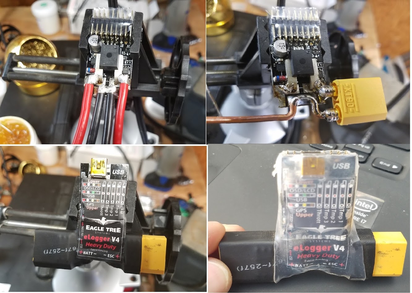

sl33py
sl33py's picture
Last seen: 9 years 1 month ago
VESC Original
Joined: 2017-05-24 12:32
Posts: 28
I finally re-worked my Eagle Tree v4 eLogger. Didn't like the unwieldy wires, so eliminated them. Now a simple XT90 in/out and much easier to drop inline to test a setup:
https://goo.gl/zVovUj
And some testing on my guest board, and GF's Vanguard i built for her:
https://goo.gl/Y6ou4z
https://goo.gl/bYowz1
Great info to know - a couple good hills around my house, one longer ride and one quick ride on her board. See consistently around 46-51A peak load. Both single setups and will test next with dual and VESC Six to compare.
