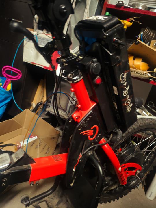

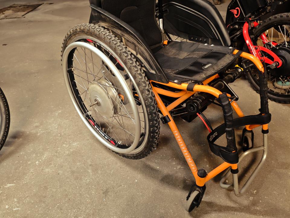

Hi, I recently built a rather unusual vehicle. I use a wheelchair and have a front-mounted electric drive unit. It has one wheel. I installed motors in the wheelchair's wheels. They're used from a bicycle. I'm powering it with VESC controllers with the latest firmware version 7. The front controller is the master controller and communicates with the two rear slave controllers via CAN. It generally runs well, but I want to enable traction control because the front wheel skids easily. The front wheel also skidded before, so I installed motors in the rear wheels of the wheelchair. And for off-road driving. But the factory-built traction control doesn't work. Leaving aside detailed descriptions, when driving at a constant speed, the front motor spins seven times faster. I'm talking about ERPM. How do I write a script in LISPBM to handle this? Thank you.
