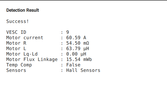

i have vesc 75100 flipsky
with motor 10 inch but i dont know how many W
in auto detect vesc tool sets it to 60A
can i use it option safe ?
i think my motor 350W
also im trying to get more toruqe in the start
its feels like the torque increases gradually.
some one can help me ?
The throttle is connected to ADC 1,
 CURRENT mode.

If it feels like the power is coming on slow, check your "Positive Ramp Time" under App settings -> ADC->General. The higher the Positive Ramp Time is set, the slower the power will ramp up.
What voltage is your battery?
When the motor is accelerating, what is the duty cycle and phase amps?

48v 21ah
Duty cycle i set it to 98%
