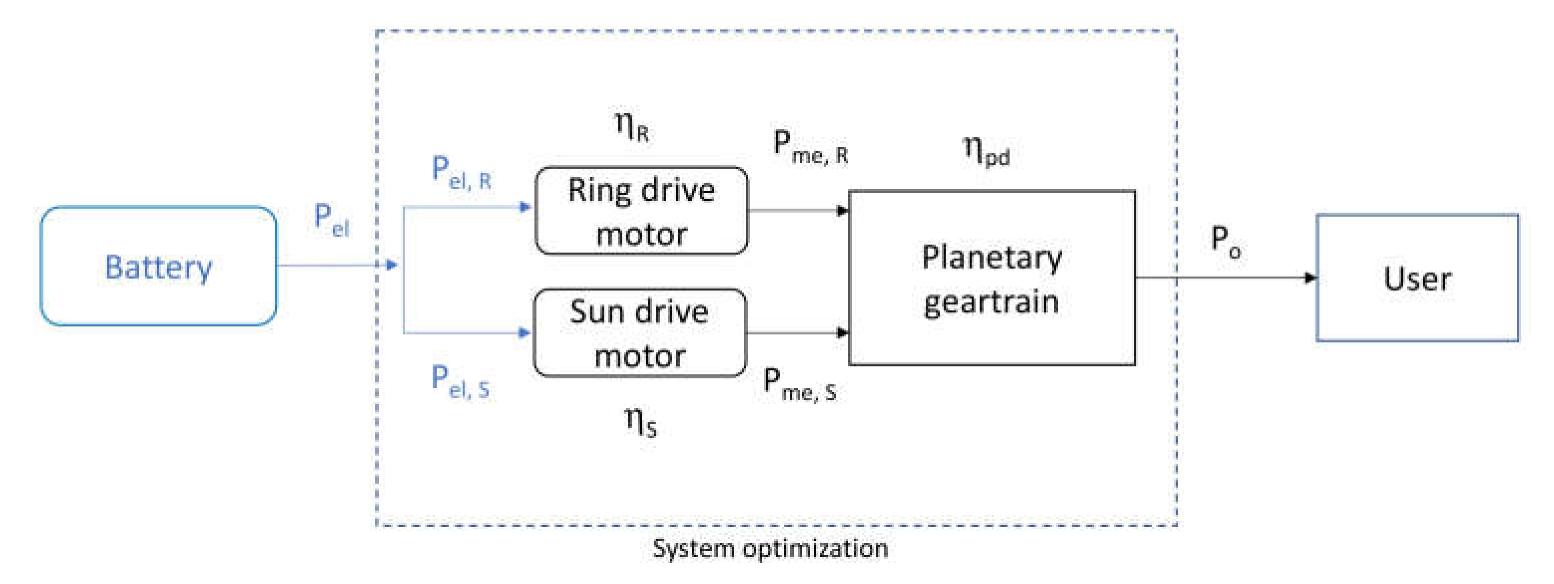

for me the problem is the following : because I'm over optimistic (or maybe crazy or stupid) I want to implement the following scientific paper : Dual-Motor Planetary Transmission to Improve Efficiency in Electric Vehicles.
Long story short : on an electic vehicle, if you use two motors in parallel with different speed, with some epicycloidal gear, you can theoretically increase your maximum efficiency map.
So my idea is to use two BLDC, so two VESC.
I'm looking for a mean to pilot the two motors at different speed. each speed Sn being of the form Sn=C*An+kn
Where :
  • Sn is the motor speed of the motor n
  • C is the consign (for an IMU or a Remote)
  • An and kn some constants of the motor n depending of the mechanism (to be ingeneered)
I know I will have to learn how to use LispBM but if someone can confirm it's possible this way. I will be very grateful.

This will not answer the question, but.... That driveline will only improve efficiency at low-speed, and only if it includes a transmission brake for the ring-gear, right?
You could probably get even higher efficiency with a single motor and a 2-speed transmission (like the Taycan).
