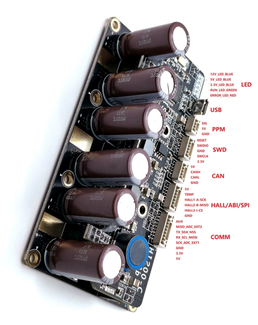

Hello i am completely new to this Forum and also not at all experienced with using VESC´s  i have got this 200A 75V Vesc compatible ESC that i need a little help with. I know it is massively overpowered, but i would like to passively cool it, so it should be okay for my application. I want to drive a Sensored Ebike Hub Motor with it and have no idea how to solder the Sensor wires to the strange connectors, that came with the ESC. Also my information is pretty limited, the only things i can give is a Picture from the sellers website, that shows a pinout for all the connectors.

As a little extra i also tried to install a Bluetooth module from flipsky to my ESC, but again i ran into problems with the pinout.

simply, hall conn;
+5V motor thin red usually
temp may not be available on motor
hallA thin yellow
hallB thin green
hallC thin blue
gnd thin black
comm.;
adc-ext1 throttle green
gnd  throttle black
+5V  throttle red
+5V  bt module Vcc
gnd bt module gnd
rx bt module tx
tx bt module rx

Just to clarify - the Throtylle's positive wire connects to the Comm's VCC (3.3v) port.
