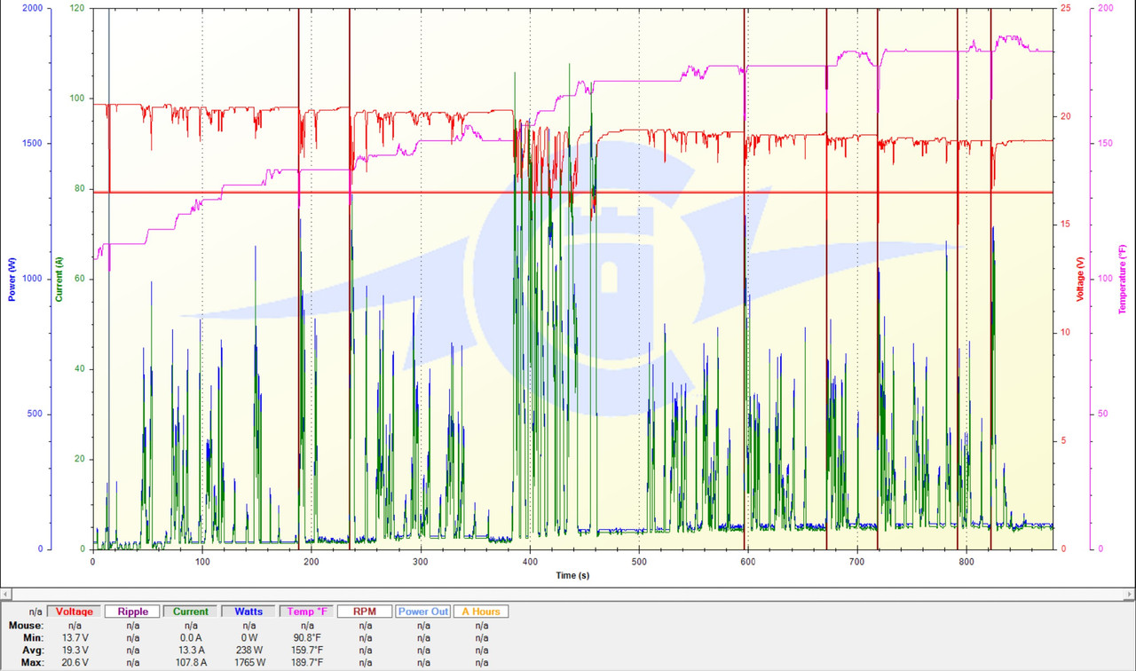

Hey everyone I need some help on how to tune my FSESC 4.20. I am doing a project with my son and we have to use 20v drill batteries, that cannot change. We are using an RC ESC right now and its flying, but when I go to the FSESC 4.20 it stutters really bad. I was able to tune it so well that it was snappy and responsive w/o load, but once a load is applied it bogs and says under voltage error. I changed A settings to motor/battery but the torque grunt was not there. The VESC-Tool auto detection said it was a 13 pole motor (but its actually a brushless sensorless 4 pole (4 magnets) drill motor), and 25-30A Motor Current and 130 Absolute max. We made a 12 to1 reduction gearbox and it helps reduce the motor load so I know its working. I tried FOC and BLDC Motor type with FOC giving the best results, and Current/Duty Cycle input, Not sure which is best. The higher the Motor amp the better the result but still lacked the low end grunt. After more research I changed the Openloop setting tab to fast start as well as Heavy load and fast start was ok, but not under load. Next I am testing the PIDs after reading about how to check and get them set but I am way outside my element and trying to crash course at night. Battery current max was 99 but should be adjusted to maybe 30-45A but would that limit the Amp output to the motor?
Does anyone have ideas/insight on how to tune? Below is a snapshot of our RC ESC that makes quick work of it w/o lag.
ESC Graph

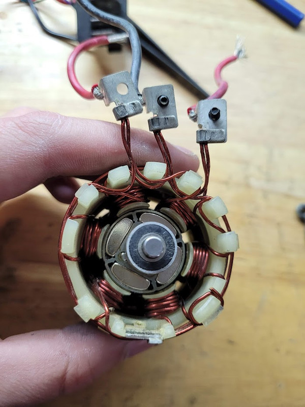

What is the motor model? Inrunner or outrunner, KV value etc.
Abcc123
Last seen: 3 years 3 months ago
Joined: 2022-08-24 06:58
Posts: 3
I am trying 2 motors. One is a brushless motor out of an impact drill, specs unknown. Looks to be a 4 pole inrunner. I am trying to use some charts online with a voltmeter and drill to find the specs. The 2nd is a Traxxas 10 turn Brushed motor, roughly 245 watts and 4500kv from looking at some charts online. Here is a picture of the brushless motor.
